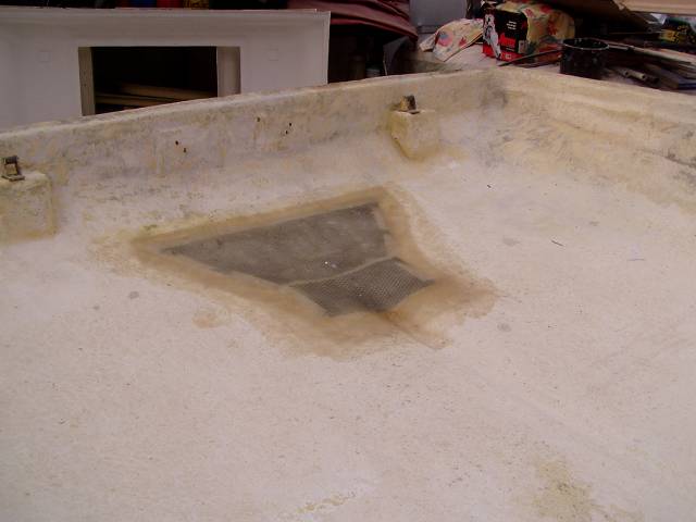

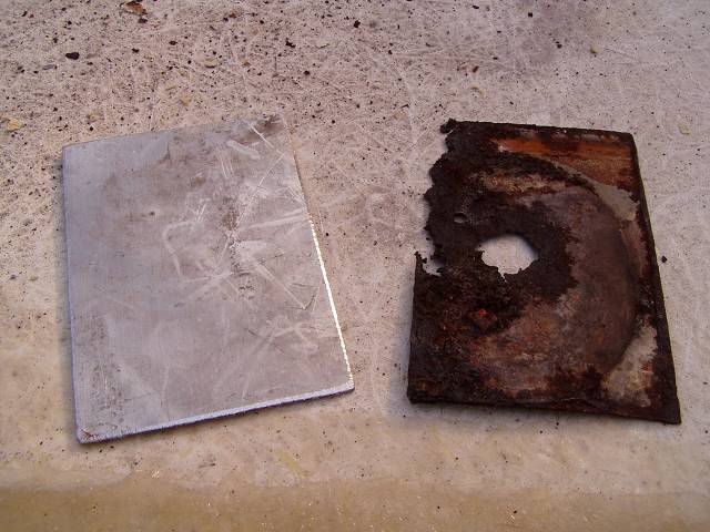

Right, didn’t take too long to work out what was happening and put a plan into action, but first, on taking off the fittings and drilling out the pop rivets, the left rear supporting steel for the roof lifting handle exploded. It had rotted out on the upper edge, and is no good anymore.
So the old one was cut out.
And a new one fabricated from aluminium.
Then, after cleaning the old mounting surface, this was installed using Sikaflex to bond it to the roof.

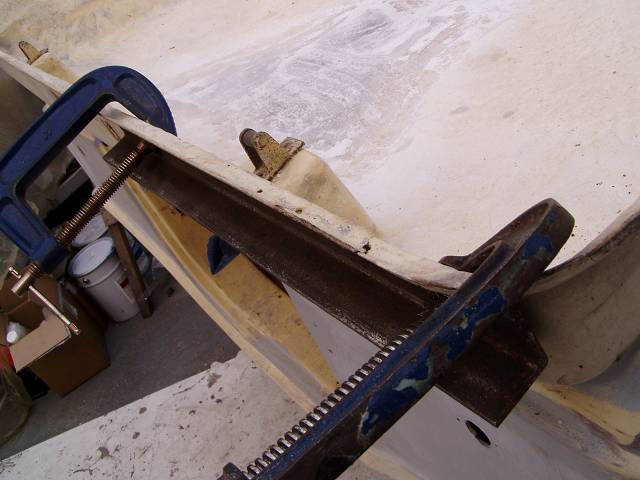

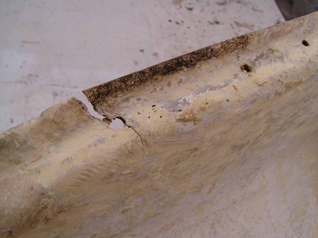

There was a small repair to do at the front edge where he roof pivots on the little aluminium sliders.
Just set up a straight support outside, ground away part of the edge and laminated the repair from the inside. The outside will be addressed when we do the repairs on the outside.

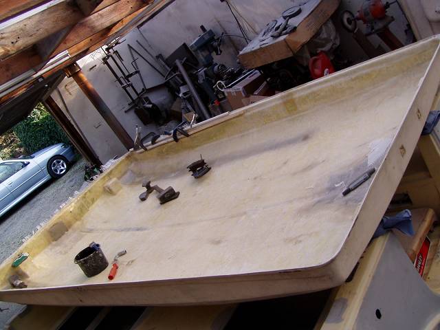

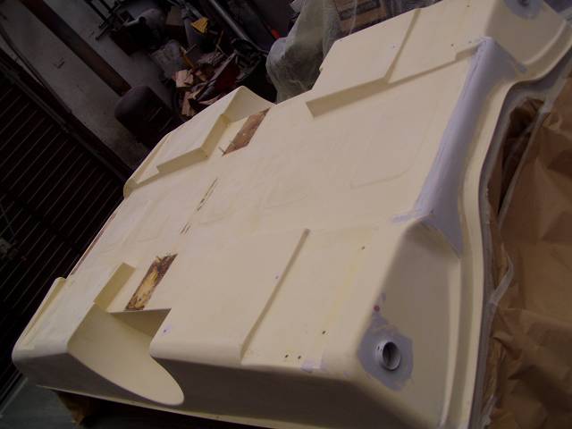

Now, on to the “sagging” right side of the roof. The problem seems to have been caused by a weakness on the inside edge of the right hand “fin” allowing the roof to “flatten” out.
With the roof turned upside down on the base, this allows the roof to take its proper shape, weight was added to the “sag” area, expanded aluminium was cut to shape as a support to aid laminating.
Both inner portions of the “fins” were laminated over and the front portion as well. This gives us a Portafold roof on the outside and an Ansfold roof on the inside, but it has worked to give a non saggy roof.
To help to make this modification stronger but still light, holes were drilled into the fins from inside and the void filled with expanding foam.

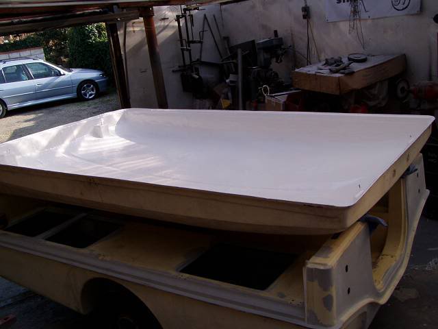

Now to make a smoother/good looking roof surface, in side, it was sanded off and a complete one piece sheet of fibreglass cloth was bonded to it. This hasn’t added too much weight to the roof, as cloth is quite light compared to chopped strand mat.
As today has been very warm, the glass has been “going off” pretty quickly , so by the time I’m back on it again it’ll be fully hard and will only require a light sanding before painting it with the white top coat. :wave:

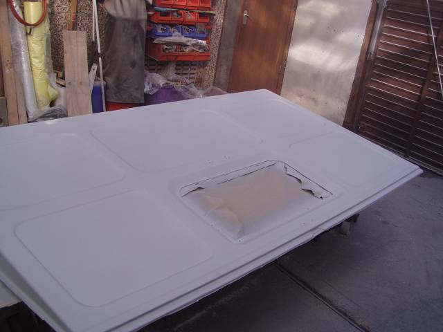

So, yes, the cloth laminate has now hardened and the edge has been trimmed and sanded. The inside has now been lightly sanded and painted over with white top coat.

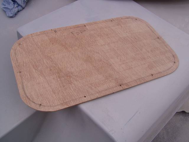

Whilst that was drying, I made the trim panel for the lower rear door, from a piece of 3mm exterior ply. It was marked out for the trim clip positions and drilled through into the door. A trial fit was made using “clico’s”, now ready to drill holes full size in readiness for the clips.

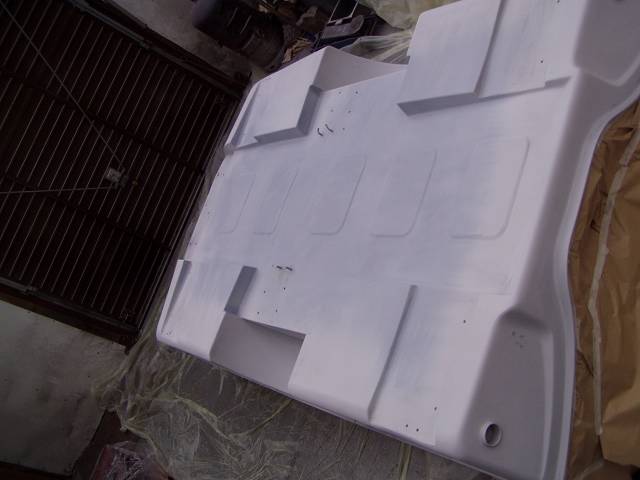

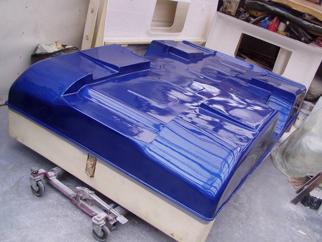

Back to the main body, after removing the chassis, the body was turned over and the final external repairs carried out. The whole of the underside, up to the join, was then sanded. We’re doing in sections because it’s easier for us, to do it that way.
It was then sprayed with primer. Firstly with a Max Mayer epoxy 2 pack primer. This adheres to the fibreglass and makes a good base for the Max Mayer 2 pack primer/filler, which covers all the pinholes in the surface of the fibreglass. This is not going to be a “perfect” job, the preparation for that would take hundreds of hours, but it will be to a presentable standard.
I’ll leave that for a few days, or so, to harden, then next week end we’ll turn it back over and finish the top area, above the join line.

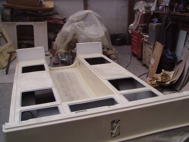

Now the primer has hardened, the body has been turned over.

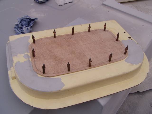

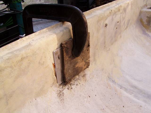

Before we go any further, the two front support/roof axis bracket fixing area needs to be addressed. Problem is that, the wooden block that the brackets are screwed into are not touching the fibreglass inside the body, hence all the cracks around the mount.
As soon as the screws are tightened, the glass is pulled in cracking the gel coat. So, just made up some packing “shims” out of 3mm exterior ply and tapped them in between the wooden block and the outer skin.

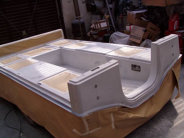

Now, having sanded all the upper part of the body, all the storage bin holes are masked up and the area painted firstly with epoxy primer and then hi build primer.
As we are going to add top coat colour this time, a guide coat of black is added.
This then sanded, untill all the black is gone. This makes sure all the marks and imperfections have been sanded out. The bins are masked up again.
The colour is now spayed on. The colour we’ve chosen for this is a period colour from the 60s & 70s, BMC “Old English White”.
After the paint has tacked off, the whole thing is demasked.
Need to let it harden off completely, then we can start to fit it up with lights and stuff :thumbup:

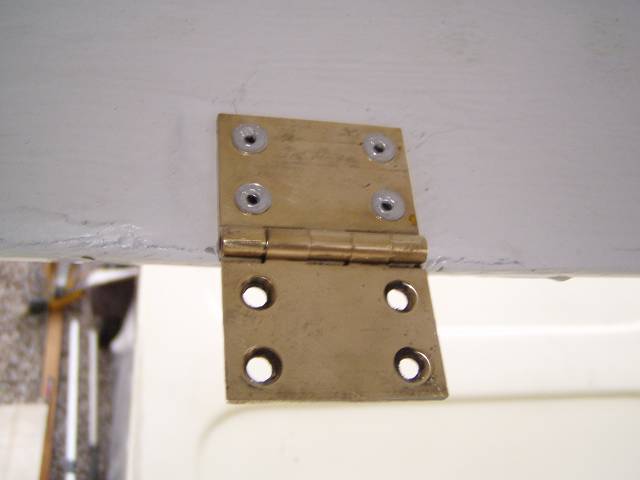

Right we are now ready to fit up the rear end. Fit half the hinges to the main body and the other halves to the lower door. As the hinges had been badly fitted in the first place and this made the lower door too low, an easy fix to raise the door would be to make two oblong brass balls to fit between the two hinge halves. As luck would have it some of the Land Rover hinge balls are a larger diameter, which just meant turning down the middle diameter to make them oblong. The door was then assembled to the body and secured.
The original style new handle was fitted with stainless steel screws.
The refurbished original number plate light was re-positioned to the centre of the lower door.
Number plate fixings were made from a couple of import lower number plate fixings and a couple of Rivnuts for the top mounts.
The rear lights chosen were the same lights that we used on our Airstream camping trailer and are of the type used on an Austin A55. They were obtained from http://www.vintagemotorspares.com for 22 quid each. These were fitted and connected. Also the reflective triangles that came with the caravan originally were secured with SS screws. And now it all looks like this...
