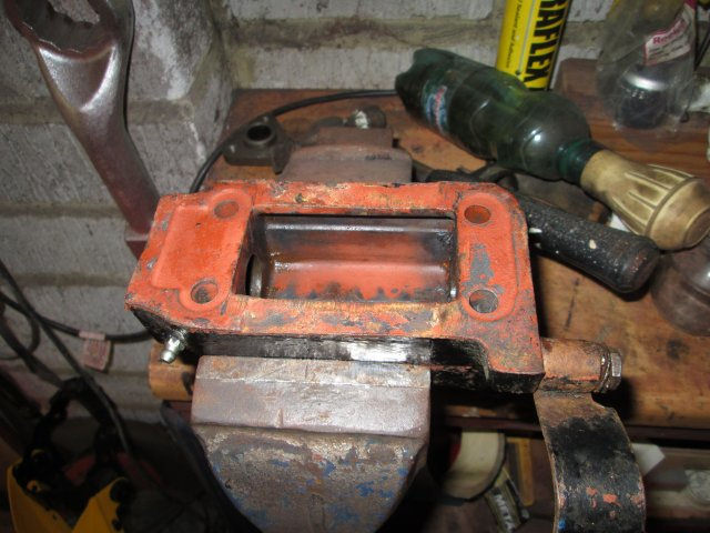

First job to clean up and lubricate the brake compensator so I can check the operation of the brake shoes later.

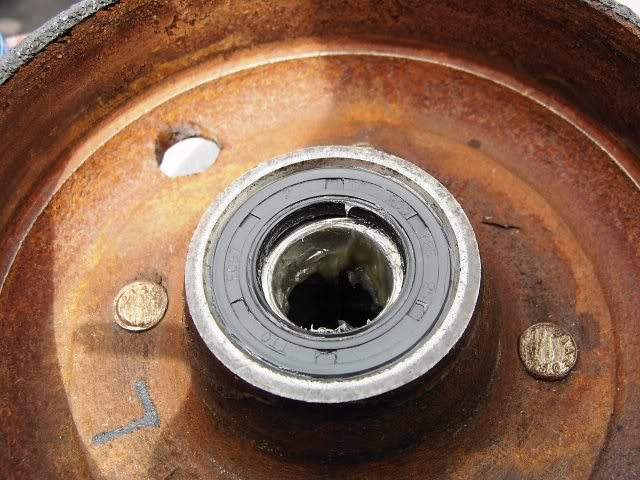

The seal is in three parts an outer and inner felt washer sandwiching a rubber O ring.

A new set of wheel bearings. I was unable to locate an original type of seal so used a normal double lip seal instead.
