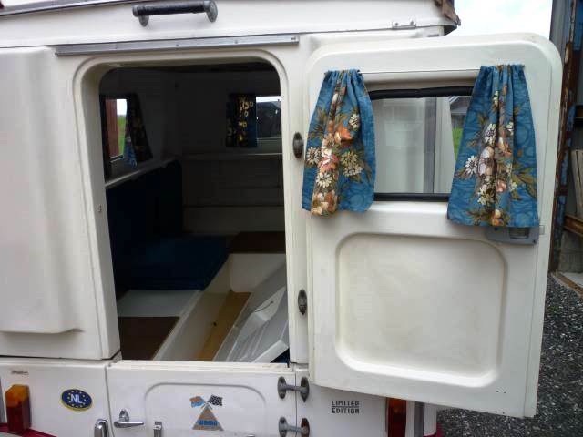

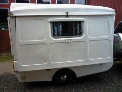

Here is the first pictures of my new owned Portafold:

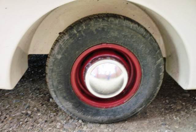

Very tidy-looking caravan you have there! Although one thing caught my eye......
In your first picture, of the van folded, I noticed how close the tyre is to the top of the wheel arch. Were there a lot of heavy things inside at the time? If not, when you load it up for use you will find the tyres rubbing on the fibreglass. Unlike a car, there is no recess above the wheel to permit suspension travel, so the clearance you can see above the tyre is the available suspension travel! Unloaded, the wheel should be concentric with the wheelarch.
My Ansfold had exactly the same issue when I acquired it, which is why I noticed it on yours. On the Ansfold, the axle is mounted on heavy steel plates which form the rear end of the A-frame. Inside the double-skinning of the hull is a large piece of 3/4" thick plywood, to further spread the load. In my case the ply had become wet & rotted; the steel plate had then punched its way through the hull floor & allowed the axle to twist round, effectively "lowering" the suspension.
I dealt with the fault by removing the axle & A frame, then welding angle-irons to the steel plates to move the suspension loads into the corners of the wheelarches. The hull is much stronger here because the wheelarches' vertical face stiffens the floor structure.

Hello Steve.
Thanks for your message.
The Portafold was not heavily loaded in the picture.
The tyres is not rubbing on the fiberglass om my Portafold.
