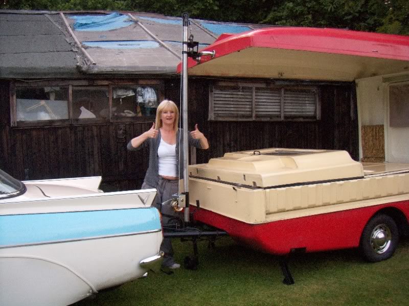

As Billy said earlier, I am sooooooo pleased to be able to put up the Portafold all by myself.......whoooppeeeee.
But.....it wouldn't have been possible without all the help and information sent to me by Steve. I really really can't thank you enough. Our lifting mechanism is not quite as grand as yours Steve but it works like a dream. I will send you some pics soon, I'm going to have a practice later and will get Billy to take some shots of me in action, so to speak.

Pics of Shelly's roof lifter as mentioned above:
Steve, as you have the knowledge I think you might have to make a batch of lifters. Or at least price them up. You could help out a lot of vertically challenged owners...
